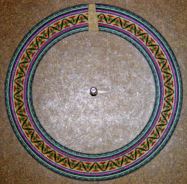

my question is: what do i do when the rosette i've purchased is not a
perfect circle? it's off by a hair, but it would not fit snugly in the channel.
aside from making a silly coaster out of it and getting a new one...
thanks

what kind of rosette is it?
PostPosted: Sat Jul 21, 2007 2:44 pm
Is it a complete solid circle and how far off is it?

its just one of those pre-made rosettes for a classical guitar.
its not a complete circle, and its off by about half a millemeter, its bigger
(or wider) than the channel.
thanks

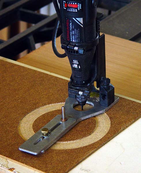

Posts: 140
I'm a first time builder and here's what I did:
I routed a "test" channel into a piece of hardboard until I got a good fit.
Then I used the hardboard channel to set the circle cutter for routing into the guitar top.

its asymmetrical by a few degrees bending outward.
i did as jim suggested, removing material around the channel, and then
gently (with some silent gnarling) pushed it in. fits good.
thanks for your help guys!
